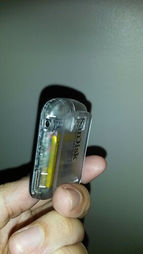

If you are looking for a fix to your problem I posted an easy solution to get the music off at least.
http://goo.gl/0ucVir
I am currently working on the firmware to be able to use the sandisk sport again but this will be slow going, even the jtag on the front of the board was locked down so this may or may not work.  My feelings of anger towards any company trying to fore you to pay additional money for something you already bought is what fueld me to find this.
Just noticed how many songs you are trying to pull, I would recommend going to the website of the icare product to see how to get the code for unlimited data transfer for free, simple and should take a moment to complete.  Can verify from my own experience they will do what they promise.
When you have the mp3’s do not be thrown off by the names, the mp3 tag data is still there so once you drop them into an android or iphone all the names will re-appear.

Hope someone finds this trick useful ;).  Should have an update on the firmware issue in the next week or so.

The files have zero protection on them.  The protection level that ATG put in the software just hides the devices storage volume from being able to be displayed and therefor from being removed.  Using diskpart, gpart, and every other command based partition tool I was shocked icare was the only one which could see the data through a data dump.  I think this is because the icare software is not a partition software by design but a tool to recover lost pictures and data from a corrupted device.
I believe you are the one who had 2700 songs, if so I would read this page.  I can vouch for the fact they will supply you the code for free so you can get all your music in one download.  With 2700 songs it will take a while to dump the data though you already knew that considering how long it would have taken to get those songs using the bop’s software.

Will add one more note to this, have received over 10 messages so far from the wordpress blog from people whom have used this technique with success.  Hate you are having trouble bro.
On a side note I may have the fix for the firmware issue to just unlock the mp3 player all together.  It is tricky and you would need to dump the music off it before hand.  I have no interest in re-using this mp3 player but I do have an interest in keeping ATG from profiting anymore off of people.
Once I can simplify the instructions I will post it up.
Firmware fix is on slight hold as of 9/4/16.  Was walking around my house and my OTG adapter hit the door frame.  Without that I can not connect to the device to continue working on it.  Another on order, will update when it gets here from Hong Kong.

Would you mind writing up anything you find reverse engineering the firmware?  As far as I know these devices are too simple for any serious 3rd party firmware development, but it would still be interesting to know more about them.
As far as reverse engineering the hardware there is no need to:
And did end up finding an easier way for this process where you should be able to keep your music intact while doing the firmware upgrade.  The firmware upgrade is a two step process, you must first dump a generic onto the device and then dump the new sandisk firmware on it.  To prove this is possible here are pics of my player:
I didn’t feel like fixing the rotation of the photos but you can get the gist of it.
The first method I had of forcing the hex file via an adroind device and purchased software + purchase adapter just didn’t seem worth while as this project was about it being free.
IF YOU TRY THIS TECHNIQUE AND YOU DO SOMETHING WRONG I AM NOT RESPONSIBLE.  If you are not tech savy enough to perform basic task then do not do this, pay the $40 and be done with it.
Back to though,
A firmware program for another player will be used, a chinese version of firmware will be dumped onto the device, and then you can plug the player into your computer to copy the upgrade.hex file to it.  The chinese firmware does the upgrade from the player so once you click update you are set.  The new sandisk firmware is actually nice compared to the locked down atg ■■■■.  Will probably have the walkthrough up tomorrow night into Thursday.
