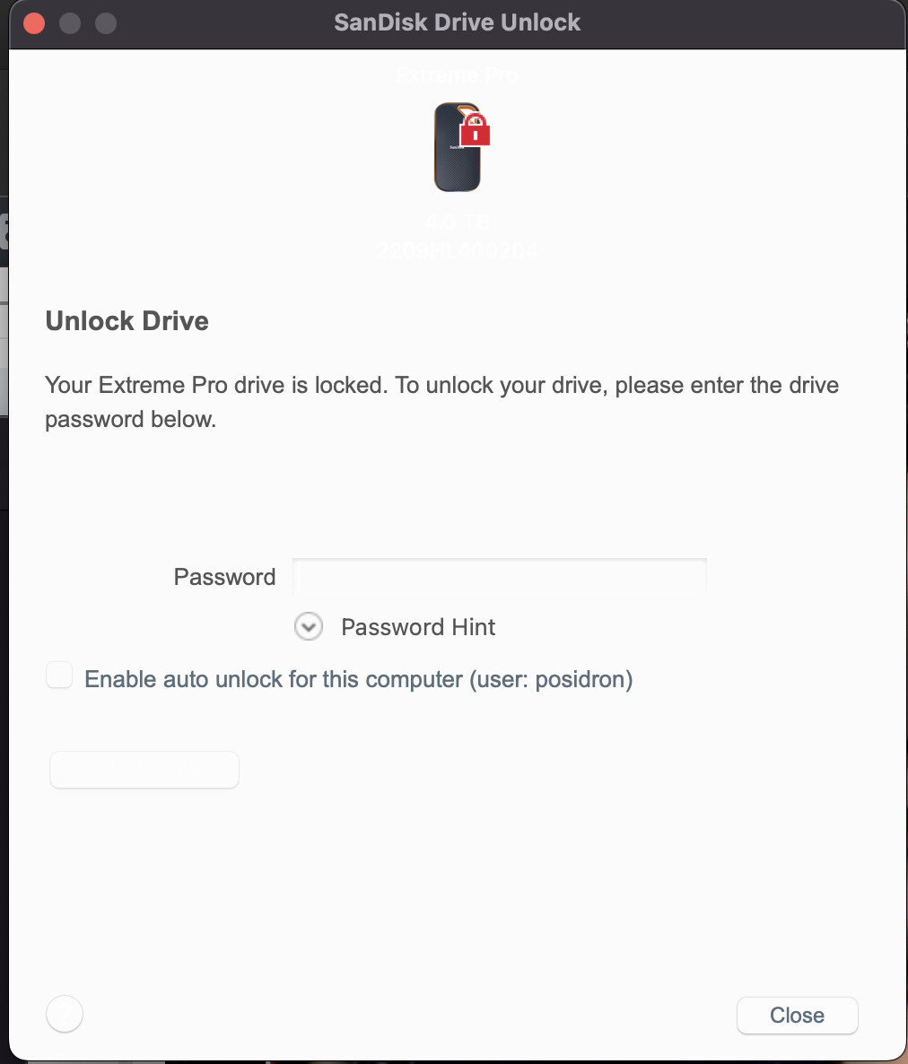

[Bug] Secure Drive Unlock and SanDisk Security is broken on MacOS Monterey
Drive Unlock is the worst issue, even the entered password is displayed in white. The buttons, the text all in white. It seems to be an issue in not respecting the dark mode on MacOS.

I have neither forgotten nor entered an invalid password.
The point is that the app displays white font on white background including the input box. I seriously can not be the only one who notices that. Is there no Q&A here?

No, it’s not about the password. It’s about the UI as white white text on a white input box is not visible, the same applies to the button and it’s about random ejects of the drive on MacOS.

But I can help you with your white keys. You are in ‘dark mode’ in appearance under utilities. You can see the ‘dots’ of your password if you change to ‘white mode’.
