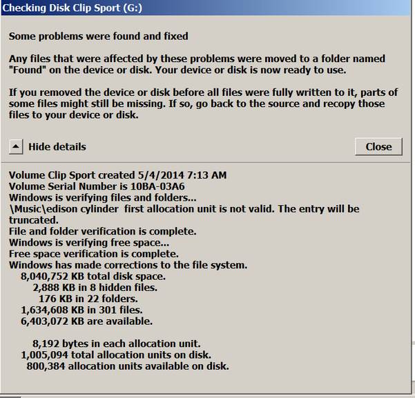

  2. The player has 6.31 GB, 1245 files, 45 folders & peformed flawlessly since several days ago. Did not do any upgrades in that timeframe & was not aware of upgrades.
  3. Tried to use 3 or 3 days ago, chargd player, went to access folders containing MP3’s but was not able to access folders as display was frozed in the FM mode.  Did some simple troubleshooting to no avail.

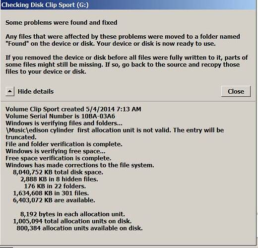

  4. Went to Sandisk website & found update, downloaded & installed. After waiting for finish, tried to access folders, still ran into problems, catiwampus output. NOTE error popup below.
  5. FM worked conected to preamp as before, no MP3’s worked, moved all MP3’s off player to HD, now player was naked.
Reloaded orig MP3’s, tried to access player: NOTE error popup below.

Ran FAT Sorter as recommeded by DFELD2005 worked. Was able to see folders with indicated sogs inside; Even with the volume turned to max, there was not enough gain to drive my pre-amp.  A few mo ago before this problem surfaced, vol turned up 1/2 way gave proper gain. Nothing else changed.
