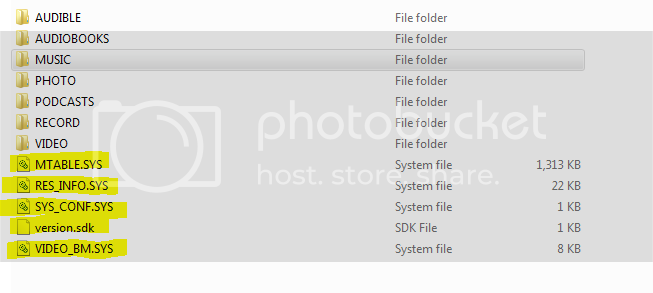

1 - in my main folder i have these files that were not there before, what are they?~

Those files that you see are the player’s system files and are seen in MSC mode. MTP mode will not show you some of these files and there are other folders that appear in MTP mode that aren’t shown in MSC mode, like the album and the playlist folders.

The files you highlighted are system files that are used by the Fuze’s firmware. MTABLE.SYS, for instance, is the listing it makes when it refreshes your media–artist, album, etc. Leave them alone.
