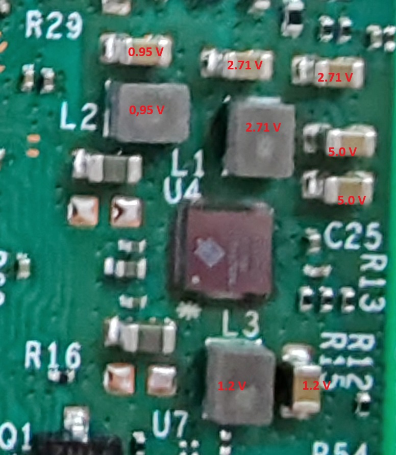

Can you measure the voltages between ground (any screw hole) and each of the 3 inductors (L1, L2, L3) surrounding the PMIC (U4)? Or measure the voltages at the neighbouring capacitors?
The PMIC is a common point of failure in other models, usually due to bad soldering.
The 0.95V supply is consistent with the controller’s Vcore.
The NAND VCC and VCCQ supplies are probably 2.7V and 1.2V, respectively.
They seem OK to me, so I suspect that the firmware may have “panicked” due to bad NAND.
That said, when the firmware panics, the drive usually identifies itself as “Sandisk Milpitas”.

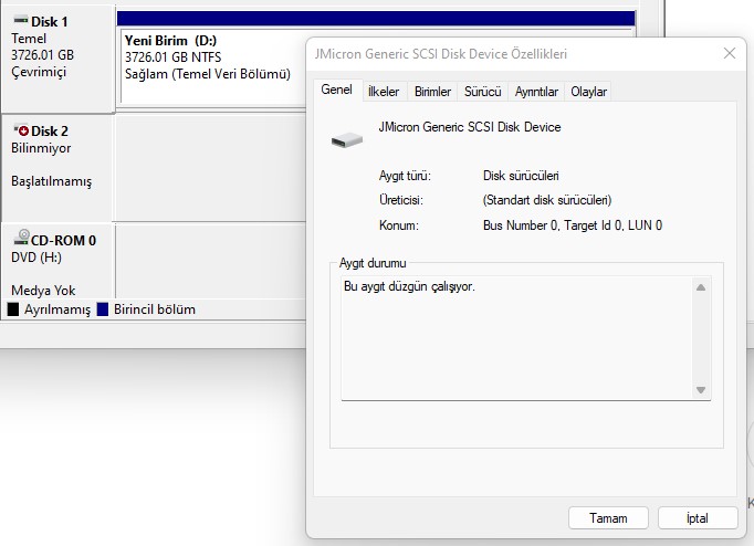

I short-circuited JP1 pins, I did not see any change. How can I see if it has entered ROM mode?
I measured the voltage between these two pads. I saw it as 1.1V. Likewise, I measured the voltage between the resistors as 1.1 V. It shows offline in disk manager.
When I try to initialize the disk I get this error: “The request failed due to a fatal device hardware error.”

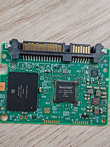

The SSD model looks like this.

As for “ROM mode”, your screenshot appears to be showing a USB-connected device. I don’t know if you can see “Sandisk Milpitas” for this type of connection.
