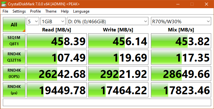

I am trying to figure out why my SSD’s are running so slow (I purchased two 500gb Extreme SSD’s). Connected to both USB-C and USB-A 3.1 ports on an Asus Rog Strix X470-F motherboard, both types of 3.1 ports are listing the following speeds on CrystalDiskMark 6.0.2 x64:
Read:44.40MB/s
Write:43.60MB/s
These are nowhere near the advertised *Up to* 500MB/s
Is there a firmware update or something that I am missing. I truly don’t understand how they can be running so slow. Any help would be greatly appreciated.
Screen Cap from CDM of new SSD attached.

Are you using the included USB-C to USB-A 3.0 cable? When I use the included cable I achieve the advertised speed.
When I use another USB-C to USB-A (likely 2.0) cable I do not. I think that may be your issue.
I have an older laptop with three USB ports. Two are USB 2.0 and one is a powered USB 3.0. This drive performs slow in the USB 2.0 ports (similar to the posts below) with R/W speeds just over 40 mb/s - nowhere near the advertised rate of up to 500.
When I plug it into the USB 3.0 powered port, however, viola. Not quite 500, but I’ll take a sequential R/W 400 Mb/s on an old machine…

I too have experienced slow transfer rates (40 Megabytes per second) on USB 3.1 ports on a recently bought a 1TB SanDisk Extreme Portable SSD. I noticed that I was having slow transfer rates on all of the USB-C to USB-A cables I was using. I was however getting full speed on the supplied far-too-short cable.
I created an account here and posted this reply in case anyone else experiences the same problem as I have a solution. The problem is not with the SSD but with your cables!
After some research, I found that the majority of USB-C to USB-A cables are rated at USB 2.0 speeds which have a max transfer of 480 megabits per second or 48 Megabytes per second. Hence, the reason why we are only getting around 40 Megabytes per second transfer speeds!).
You need to ensure that your cables are USB-C to USB-A 3.0 which is also called 3.1 Gen 1. A USB-C to USB-C cable will also work as long as it too is 3.0 or 3.1 Gen 1 compliant.
USB 3.0 (also called USB 3.1 Gen 1) supports transfer speeds of up to 5 gigabits per second or 500 Megabytes per second.
You will need to buy ‘faster’ cables which can support 5gbps transfer rates. Carefully read the specifications. I am in the UK and bought some Anker and Amazon Basic cables sold through Amazon UK.
Search Amazon for either “ANKER POWERLINE+ USB C TO USB 3.0 CABLE” or “AMAZONBASICS USB TYPE-C TO TYPE-A 3.1 GEN 1 CABLE” and purchase those.
I hope this helps! Take care!

Try and reverse the included cable. I was also only getting 40 something mbps. Reversed the cable and boom. My 2015 13” MacBook Pro is getting 450~ish mbps.
