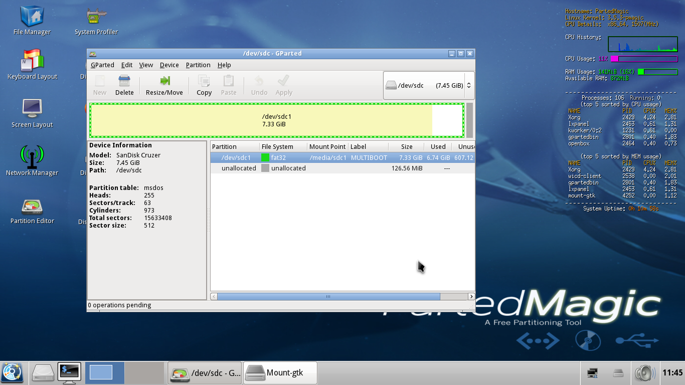

Thanks. I fooled around for an hour with TestDisk and temporarily changed the cylinder count (doubled it) and temporarily had 16GB, but when I wrote the changed and recycled the drive (removed and replaced it in the slot), GParted showed only a missing allocation table. So I went back into TestDisk and put back the partition table I had when I started the operation. The drive is again as it was when I started this thread. I see no way to get it back to 16GB for real, though I’m sure there must be one.
I rand USBDeview, which I had mentioned previously in this thread. Here is the result for what I think was the Cruzer before I changed it and from the no-name USB drive I cloned with dd as per the thread subject.
And here is a screen shot from GParted of the Cruzer currently.

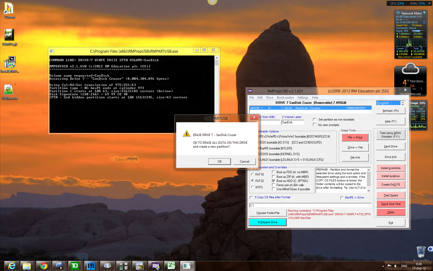

RMPrepUSB is quite a nifty thing. It didn’t fix the problem, but it was sure interesting to play with. I tried most all the relevant options. At the end, the drive is trivially smaller than before. :slight_smile:
Anyway, I have the USBInfo.Txt file. In pertinent part:
Disk Signature bytes (1B8h-1BBh) = 12 98 08 00 Partition 1 SIZE=7506.905MiB Type: 0B FAT32 (2047GB max) \*ACTIVE\* START POS = CYL:0 HD:1 SEC:1 END POS = CYL:956 HD:254 SEC:63 START (LBA) = 63 (0000003F) SIZE (LBA) = 15,374,142 (00EA973E)
This geometry is now different from what I had before I went all destructo. I had 255/63/973 heads/sectors-per-track/cylinders, with 1563408 sectors, earlier in GParted. So I have fewer cylinders (and therefore total sectors) now.
 I’d be mightily interested in what your Cruzer says. I did read in the RMPrepUSB dialogs that the max possible cylinder setting is not at all as high as what I tried in TestDisk before. But I’m more interested in knowing what the sector size on yours is. If it’s 1024 instead of 512, that would be an easy answer.
The drive has the hidden second partition that causes the extra 126 MiB at the end versus the drive I cloned. That might or might not account for the “missing” cylinders. I did the testing a couple of times, once with the tickbox checked for that extra hardware bit, and I can’t remember which test this was I’m reporting the results of.

Also, hereis an RMPrepUSB screenshot from when I tried the extra hardware bit. This is just FYI.
