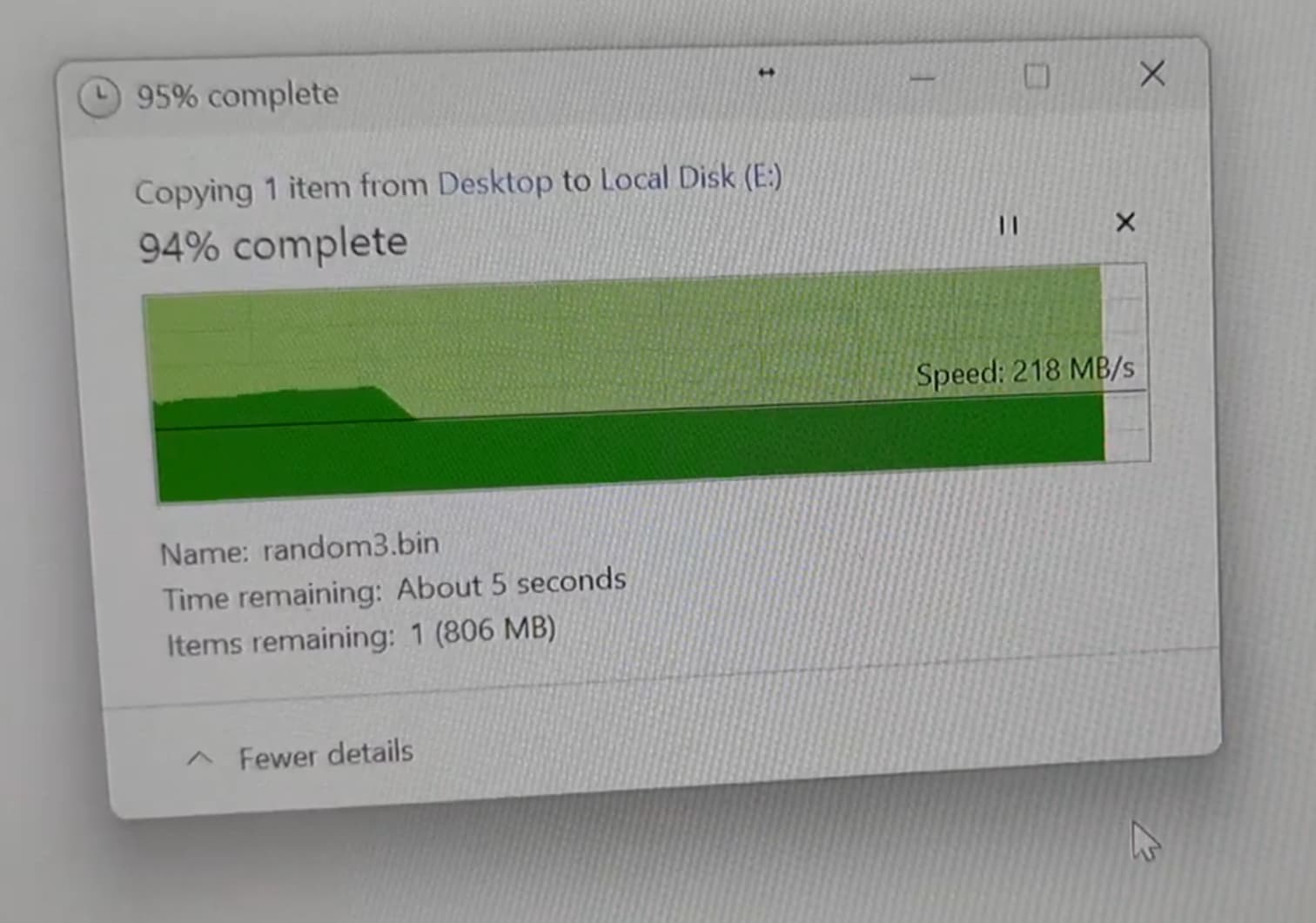

to test the maximum sustained write speed of these cards. They’re specified at “Sequential Write Performance 650MB/s”. However, when I try to copy a single 16gb file with random data from an internal PCIe4 SSD to the sdcard (exfat, 128kb cluster size, empty) in Windows 11 Explorer, the data rate starts at around ~300MB/s, then quickly drops to a very constant 218MB/s:

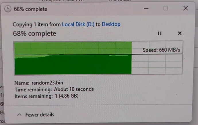

Reading doesn’t hit the advertised 880MB/s either, but it gets a little closer, and that tells me that the USB connection between CPU and cardreader isn’t the bottleneck:

@SBrown, I’m getting a net transfer rate of 660Mbytes/s while reading, so 5.28Gbit/s. That tells me I’m using a port with a signalling rate higher than 5GBit, of which USB 3.2 Gen2x1 with its 10GBit/s seems to be a likely candidate, as it’s the next faster one, matches my laptop port’s spec and the reader’s spec as well… and I’m using the cable sandisk shipped.
I haven’t yet seen a USB connection be faster in one direction than the other, so I assume that this connection can transfer at least 660MByte/s in both directions.
@Vegan , looking at the USB signalling rates at wikipedia’s USB page, I think you’d be wrong even if I complained about 985MB/s (which is the limit of PCIe Gen3 x1). But I’m complaining about 218MBytes/s, which is well below USB 3.2 Gen1x1 limits.
So I don’t think it’s the reader or connection - it’s the card. And in the meantime I have found Sandisk saying “210MB/s minimum sustained write speed” in the footnotes of the card’s product page. I’ve never seen it there before, so not sure if they just added it or I just didn’t catch that earlier.
Guess I’m just a bit disappointed that it degrades from only half the marketing-spec of “Up to 650MB/s write speeds” to a third of the marketing-spec so quickly while writing.
But seeing how the guaranteed-sustained speed is 100MB/s for the 128GB card and 218MB/s for 256GB card, I have hope that the 521GB card’s speed will scale the same way.

Hey, thanks for putting all that together—it really helps. From what you’ve tested, it does look like 218MB/s is just what the card can handle in real use, no matter the setup. That “up to 650MB/s” clearly applies to short bursts, not long transfers, which is kind of disappointing when it’s not spelled out clearly.
And yeah, since you’re getting over 600MB/s read speeds, the connection’s definitely not the issue—it’s the card itself. Let’s hope the bigger capacity ones don’t throttle as quickly. But honestly, the way you’ve tested it across so many systems really clears things up. Appreciate you sharing all of this.
