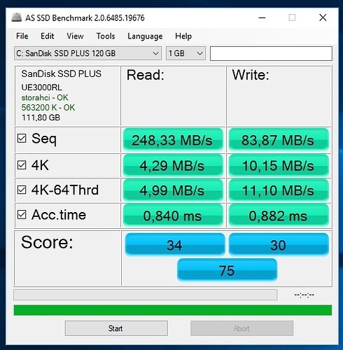

Sandisk SSD Plus 120GB - Bad Performance
hi…
got this ssd a few days.
any hints why the performance is so bad in writing?
Hi Paparansen,
It seems the read speed is ok but the write speed is really low, can you try to sanitize the drive with SSD Dashboard and test again ?
If the issue presists please contact our support center for a possible replacement
“can you try to sanitize the drive with SSD Dashboard”
what do you mean by that?
btw i tried another ssd ( sdssdp128g ) and get writing speed about 300-320 MB/s
in SSD Dashboard software if you go to Tools tab you can see sanitize option on the left, this will wipe out all your data on the drive so make sure you have back up before you do it
If you tried the SDSSDP on the same port, it seems to be performing at reasonable speed, I think replacing the drive will likely fix your issue
ah ok, i will do the “sanitize” and report the result. will be after the weekend.
so, i did that sanitize thing. now i get about 160-180 MB/s
