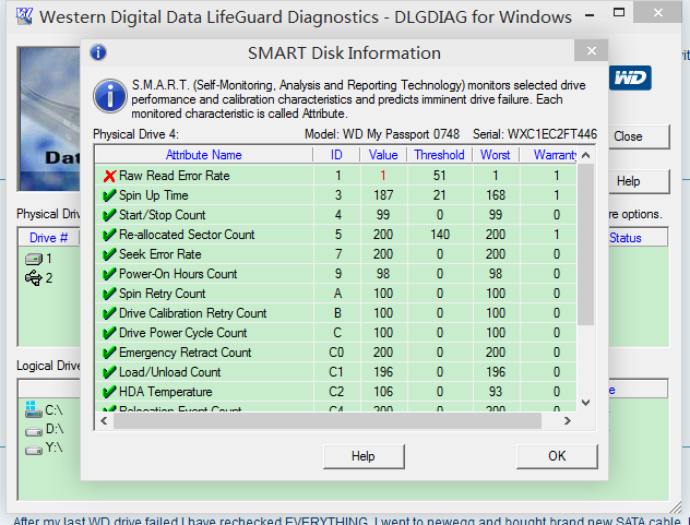

This is my WD’s Error! It seems like not working now. The speed is very slow.(about 100k/s~700k/s). Is there anying way to solve this solution? :cry:
Test Option: EXTENDED TEST
Model Number: WD My Passport 0748
Unit Serial Number: [Deleted]
Firmware Number: 1019
Capacity: 1000.17 GB
SMART Status: FAIL
Test Result: ABORT
Test Time: 16:38:45,
Test Option: QUICK TEST
SMART Status: FAIL
Test Result: FAIL
You might try formatting the drive with DLG by writing zeroes. It sometimes fixes bad sectors. It will destroy any data on the drive.
Joe
But, the problem is that the wd has stored about 900G important data! It’s very import to me. Anyway, I can’t copy them to another wd. Because the speed is just about 100k/s~700k/s. I don’t know what I should do. You said the DLG that it may be work by writing zeroes. Is it true that some bad sectors in my WD? I hope you could tell me more about the red error info! Thank you!
