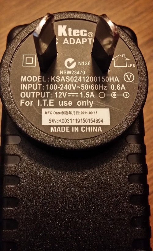

I have a 2TB WD Elements (and a 3TB and 4TB Elements) … they all use the same rating power supply.
here’s a photo i took of it ![]()
Dear JoeySmyth ,
many thanks for your answer and picture , I will proceed to buy correct charger .

Do you (or does anyone) know what the US equivalent DC power supply adaptor is? Mine is lost and I need to buy one. I think mine is 1 TB.
For Reference, the hard drive’s P/N: 10000H1CS-00.
Thanks in advance.
The power supply rating for US is the same rating for all other countries it’s a switching AC adapter good for between 100V to 240V Input and 12V 1.5A Output.
(the only difference is the plug type which you can buy inexpensive universal adapters for a few bucks to convert the plug to your country socket.)
This is my WD Power Supply that came in the box (below)
It’s Australian plug type … but will work fine in the US with a universal adapter
