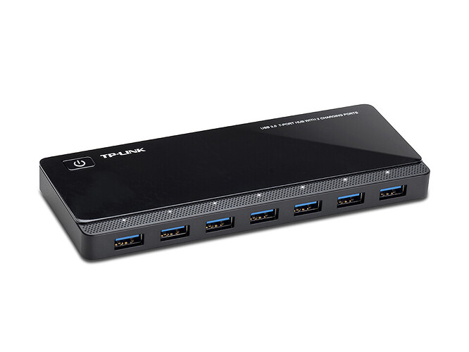

When I use a powered a USB 3.0 hub, the disks work even without the original cables. I use the same model I have on my desktop PC, a TP-LINK UH 720, which has a 4 Amp power supply

Actually, the issue that you are facing is may be due to the power supply, we never recommend to use the external drive with the USB HUB.

I only tried a powered USB hub after these problems started, so it can be the cause.
Actually, I was a bit reluctant on using USB hubs, but they are going to be very hard to avoid in the future, because I’m switching form a laptop to a more powerful desktop PC, and there is no other practical way to connect portable HDD’s.

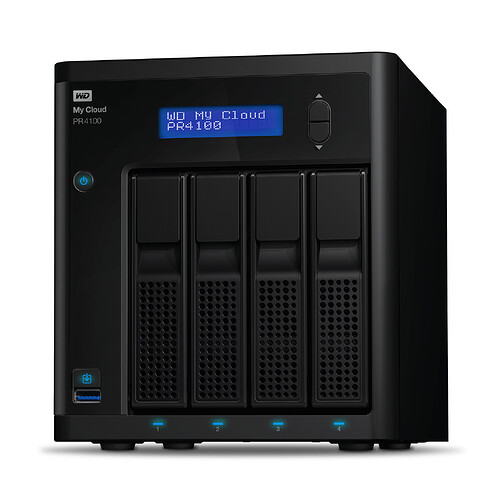

Could I just star with a MY CLOUD PRO SERIES PR4100, and a single WD RED drive, and then keep adding drives, in JBOD, when I need more space.

I have a My Cloud DL2100 the series that preceded the PR Series. When I send video files from Win 10 PC through gigabit network, I get 113 Mbps; NAS specs are 115 Mbps. Not muxh dif. Maybe you need the PR2100 model with a cou;e of good size drives.
RAID is best for business purposes, but for a home server that has copies of all the data on other drives, pass on RAID and save the disk space… Just set up both drives as JBOD. I regret setting mine up as RAID1 and need to change to JBOD. Naybe you need the 4100 seriesl only you can decide, but I would set up two, and then add others if you need them.
