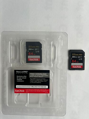

Same serial number on both Extreme Pro cards
please help, immediately , I need ro rush back to the shop if these are counterfeit to get my money back

Hi @sandanuwan,
The cards you have here are confirmed authentic SDSDXXU-064G-GN4IN units. The serial numbers being identical is normal, in this particular instance. These cards were most likely manufactured on the same day, in the same manufacturing center.

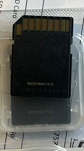

Your card’s serial number is BN25078001721Z.
This page suggests that the correct serial number format is CCYYDDDXXXXXL.
BN25078001721Z
CCYYDDDXXXXXL
CC = BN - product code ??
YY = (20)25 - year
DDD = 078 - day
XXXXX = unique s/n
L = location of manufacture ?
Clearly, your s/n has an extra X.

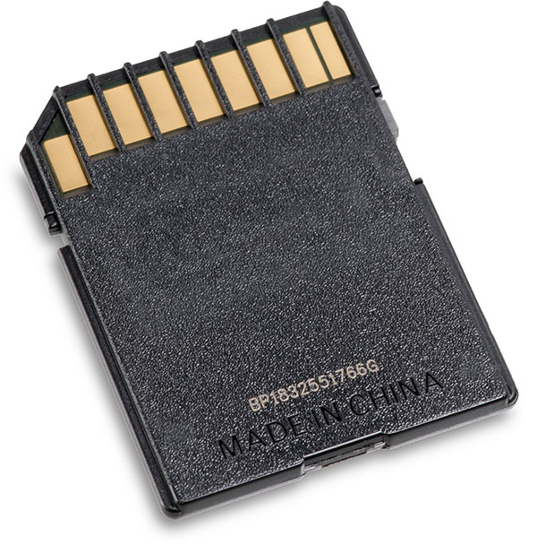

Here is a genuine card:
The s/n is BP1832551766G.

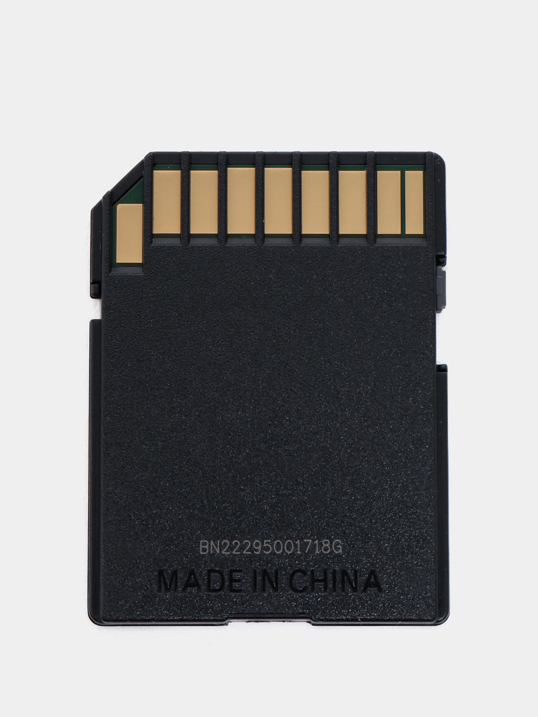

https://images.uzum.uz/cf8hdrgv1htd23algddg/original.jpg (BN22295001718G)

BN22295001718G (uzum.uz, vendor)

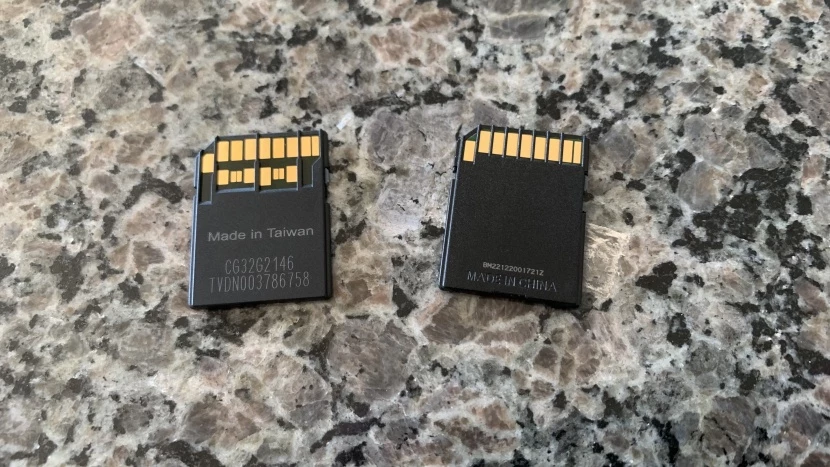

Hey, look at this:
The 5 Best Memory Cards of 2025:
This is a photo from that review:
The s/n on the UHS-1 card is BM22122001721Z. That’s day #122 of 2022. Compare that s/n against your own:
BN25078001721Z
BM22122001721Z
  YYDDD^^^^^^L
Notice that all the digits except the date are identical. What are the odds of that?

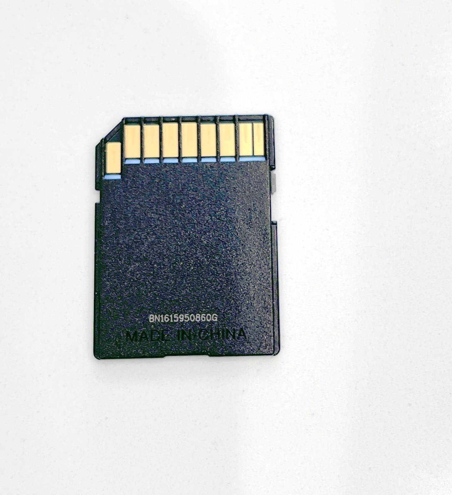

Edit:
Here is a BN card from eBay:
s/n = BN1615950860G
That has the correct number of digits, plus the manufacture date fits in between the BM and BP cards, as you would expect for alphabetical order.

My reply was a statement, not a guess.
Could you now please correct the errors in SanDisk’s knowledge base article? I prefer to rely on official documentation, but I wasted many hours after SanDisk’s errors steered me in the wrong direction.
The correct answer to the OP’s question is that the number on the card is not a serial number, as incorrectly identified in that article. However, that article correctly states that serial numbers are unique, hence the confusion.

@fzabkar thank for pointing this out. We will get it fixed ASAP!
That should be Date Code.
I also got the same problem. both cards have the same serial numbers
