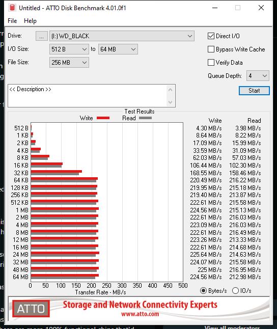

If you see my post, why is the read speed lower than the write speed on my disk?
Asking because every single review I have seen online from 2020 show that there are always equivalent read and write speeds.
See for instance this ATTO result: WD Black D10 Game Drive for Xbox 12TB Review
