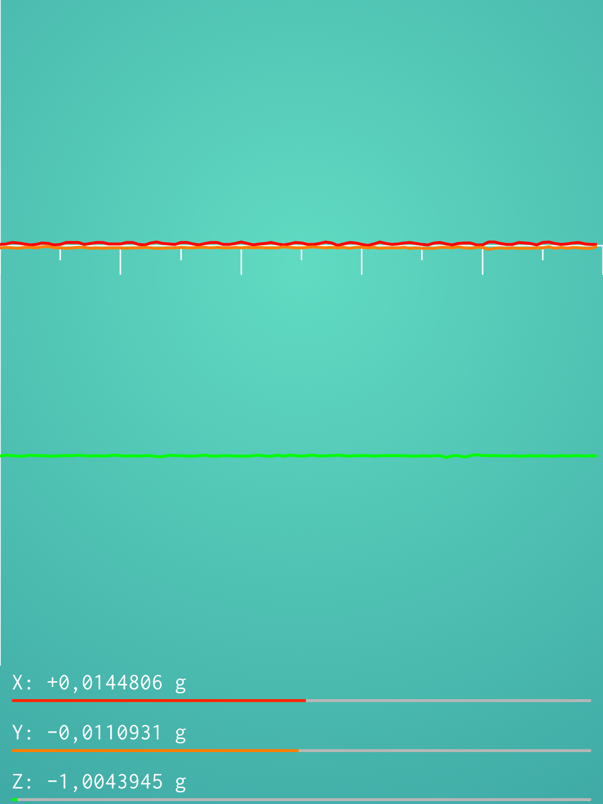

Since there is no better way to just describe the sound or the intensity of the vibrations, this is what they look like when measured using the accelerometer sensor on an iPhone (with the iPhone placed flat on top of the enclosure and left there). As can be seen from the image, these are quick, fast vibrations, not that big in amplitude but easily felt since they are quick.
My Book:
And just for comparison this is a 4-bay NAS with 4 x WD Red 4 TB drives, clearly not generating as much nor as intensive vibrations as the My Book:
