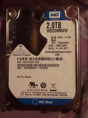

I have a wd easystore 2 tb.it fall down.now it dosent work.
How can i buy a hard disk head for replacement.
Thanks

I can find the one i have in your list.
There are several characters in the DCM that you should try to match. You should also match the full model number, plus you should match the head map.

Your model belongs to the Pebbleb family.

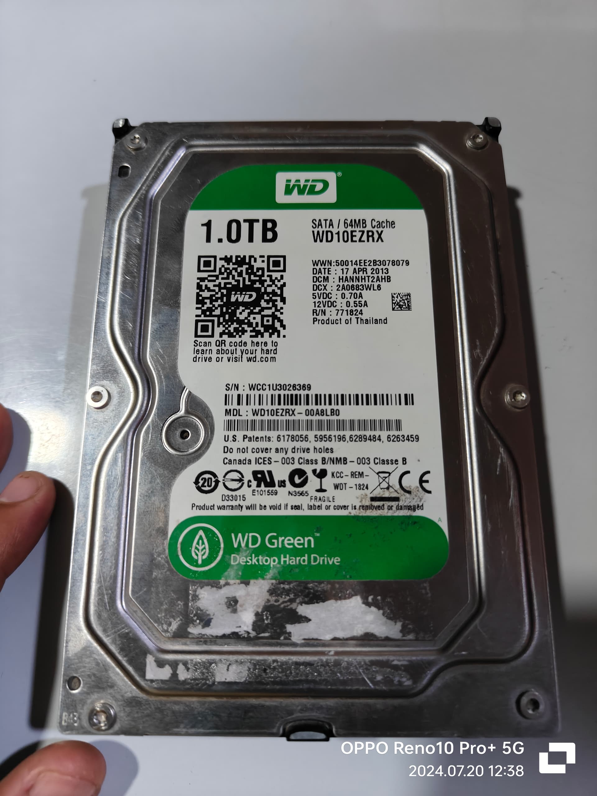

Could you tell me where i can buy this donars. Same is my.
Thanks
Data recovery person charged 10times the hdd cost…of head replacement and told me no graunteed of data.plz help me with this
