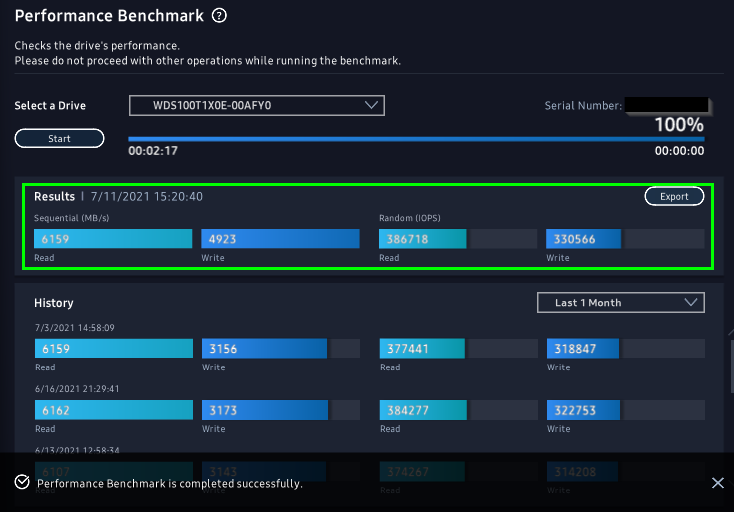

Edit: Firmware update available now and write speeds are now at almost 5000mb! Looks like it did the trick and the CPU lane M2 install continues to operate as it did before too. The firmware seems to have also bumped up the Random IOPS a fair chunk too.

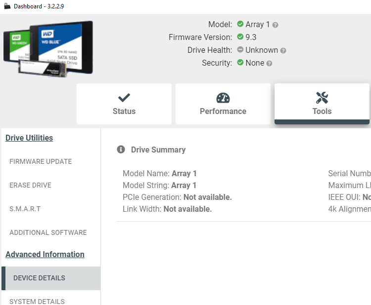

anyone recognize this missing file error? reinstalling, running as admin etc. doesn’t help get past “Loading…” on the Dashboard. I found these errors in the text file in the install dir C:\Program Files (x86)\Western Digital\SSD Dashboard
No idea what’s going on there, its possible that the array is stopping the Firmware in some way, perhaps you need to break the array, apply the Firmware then rebuild the array?
Doesn’t make sense that the array would break the ability to update the Firmware but the dashboard screenshot does appear to indicate that it can’t detect the NVMEs individually
Your only option may be to move the 850s to a different PC, secondary to the OS drive and update that way, or worst case backup your OS drive, remove the NVME arrays, redeploy the image to a new SSD, boot into that and then check if the dashboard can see the individual 850s. Macrium is good for backups.

Hi there, i had the exact same problem as you, 2xSN850 raid-array thru a X570 Motherboard, Dashboard can’t find the drives. I Solved it like this: Got a laptop with a 2.5" disk in it with win10 on. Removed the drive, attached it to a usb-dongle so i could boot it on the pc with SN850. turned off Secure boot and turned on Legacy boot in the bios and chose to boot on the usb-connected drive, then when that is booted i installed Dashboard, because the array is not configured here, now it can identify the drives, and i could update the firmware. Then i shutdown, removed the usb-dongle with the extra drive, and booted into bios, turned on secure boot again and turned of legacy boot, then boot up as normal, everything ok.

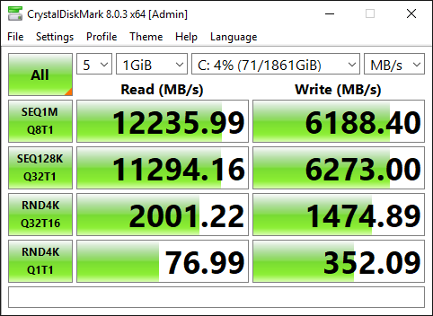

i updated the firmware on the new drive before i set up the raid. Once I managed to get raid setup i did a benchmark and the read speed was around 6450 and write speed was only 7000. with the drives seperate i was getting the same read speed and the write speed was about 5300
I have a ticket raised with WD because I’m still concerned there is an issue with the read speed because if i turn my wifi adaptor back on the read speed drops to around 6200 and now with the raid 0 set up I’m not getting anything like the numbers expected
