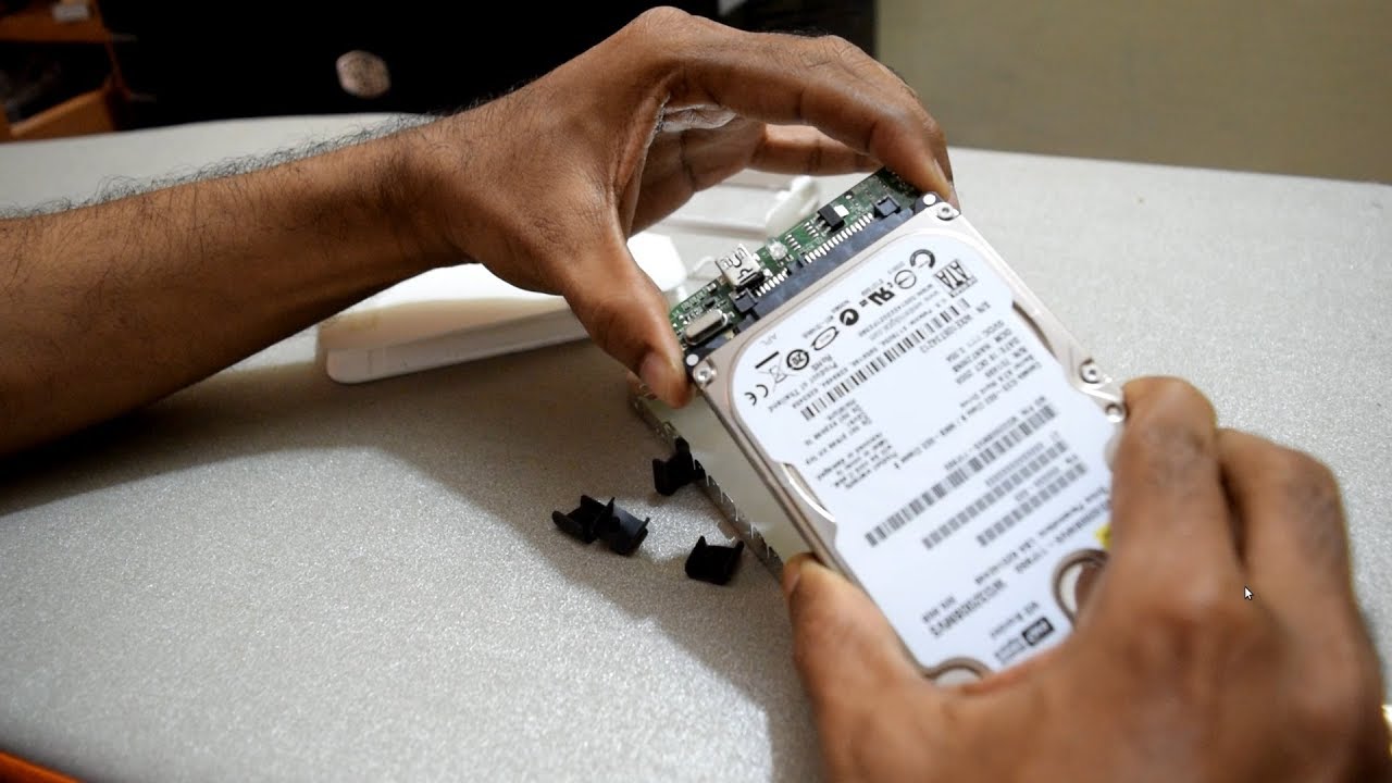

Because you’re WD Passport is OLD … it uses a standard SATA Connector with a USB daughter board connector which you can unplug.
Newer WD Passports don’t use a standard SATA Connector … the USB is integrated into the board.
Now because your WD Passort uses a standard SATA Connector you can disassemble the case, remove the Internal Hard Drive and either connect directly to a Desktop PC or insert into ANY 3rd Party 2.5" USB Enclosure or Dock … the advantage as well is these will be USB3.0 so, if there is any data on the drive, you’ll be able to transfer it quickly.
Oh, and if you do buy a 2.5" Enclosure … it will come with the correct USB Cable

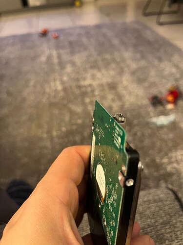

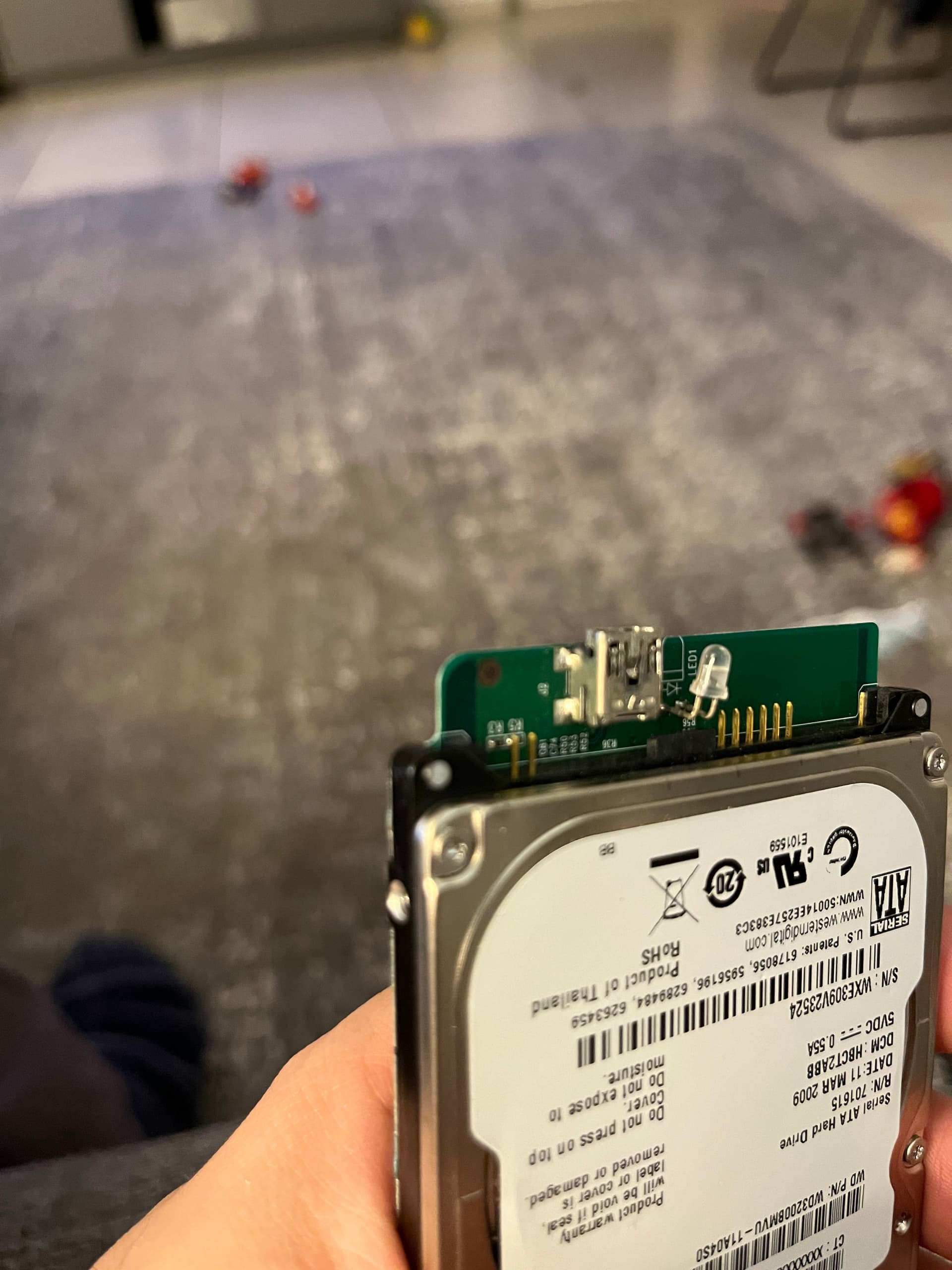

I was soo happy seeing your post. Many thanks. There is just one problem. I removed the cover from the hard drive and it seems that I have a slighty newer version. The USB port seems to be on the board.
I have another WD Driver with Micro USB. Maybe if I buy an adapter to Mini USB?
Or are all USB sync cables the same apin configuration and I can another one?
