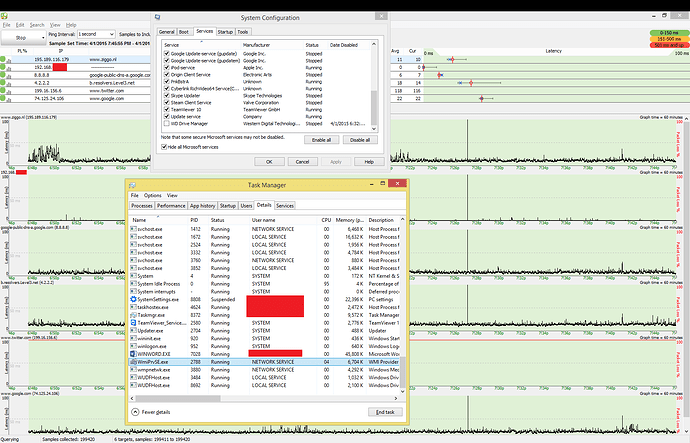

I added some pictures to let you show that WD Drive Manager is causing this problem. Below as well my WD devices and PC info.

WD Drive Manager Disabled:
To enlarge: Right click → Open image in new tab
On the left of the graphs you can see the bounds of latency, which is 0 to 100 . The only IP coming above 100 is Twitter.com (not sure why, but this one always has a ping of 120-140, on all other devices i tested). But none of the other IP’s are coming above 100 in the last hour.
