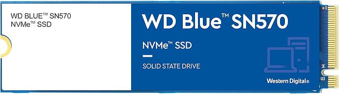

So I just bought a brand new WD Blue SSD on Amazon, here is the link to the one I bought…
I bought it to add it into an external SSD enclosure to use with my laptop for extra storage, which here is the link to the one I bought…
The problem is, I don’t have a USB-C plug-in on my laptop, and the cord that that enclosure comes with is just USB-C to USB-C, it does not include a USB-C to USB-A. So because of this, I bought an adapter, USB-C Female to USB-A Male. I can post link in the comments because this won’t let me add more links :frowning:
