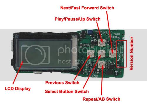

Layout of m200 circuit board
SanDisk Sansa m200 Series MP3 Player Circuit Board Layout (bottom)
  1. Headphone Connector
  2. USB Connector
  3. Battery negative connector spring
  4. Power On/Off Switch
  5. Volume Down Switch
  6. Philips TEA5767 FM radio
  7. Volume Up Switch
  8. DM 621 Battery
  9. Socket for Flash Memory (not shown)
  10. Battery positive connector spring
  11. 1 Meg RAM
  12. Main Processor - Telechips TCC 770
  13. TI Stereo Amplifier
  14. Hold Switch
  15. Microphone
Many of the components were covered with black foam pads which were removed for the photo.
Top side of m200 Circuit board showing the LCD Display and the diaphram type switches.
  The revision number on the card.
Must match the firmware level on the unit.
Memory Card
Note that it is made by Samsung.
This is a 1 Gig chip, the only physical difference from a 512 is the lettering on the chip.
No components are user servicable except the flash memory card
Thanks to “turbodog” on the anythingbutipod forum for information on the chips.

The DM 621 battery soldered on the m200 circuit board is to keep the Real Time Clock (RTC) alive during power off.  The clock is only used to check expiration of timed items such as borrowed books from libraries, etc.  Since the m200 series is an “economy” model, SanDisk chose not to include a clock in the display.
The chipset also supports a recovery button, but again, SanDisk left that off.  Since the m200 is no longer manufactured, there’s no hope of having it added.

so, whats the possibility of adding a bigger memory chip to the board?
Re: Adding a bigger memory chip to the m200
I did just that.  I bought a m230 (locked up) and a m240 (broken display) from Ebay for $6.99 shipping included. Took the memory chip from the m240 and plugged it into the m230.  The m230 has a version 2 board and the m240 had a version 1.  The m230 is now a m240 version 1.  The version (firmware) followed the memory chip. Can’t guarantee this will work for everyone, but it worked for me.
Incidentally, the sound has gone out on the second circuit board, so I now have two non-working units. If you buy a “locked-up” unit, chances are very good it is the memory card.  The m230 would not power on and was not recognized by the PC, but it works great with the m240 memory card (except for no sound).

Do you know if the “8. DM 621 Battery” is replaceable?
I have a M200 series and it is giving me the “Sync Notice” until I reload the new firmware.  I just noticed the other day that the battery was going low, and when I changed it I started getting the “Sync Notice” again.  I think that the internal battery might be dead and causing the error.
Also if the battery is replaceable, are there any tricks or special tools needed to take the case off?
Thanks in advance for the help!
I doubt you can find a replacement battery.  I have tried several times and failed. It is a simple button lithium battery as in watches, but it must be rechargeable.
To open the cover, you may be able to just pull it apart, if not, insert a flat blade in the seam around the edge and pry it.  You may scratch the case doing this.
I doubt you need a new battery.  It should recharge from the AAA battery.  Don’t let your battery get below 1/2 on the display.

The DM 621 KORCHIP is in fact a “starcap”,
see http://www.51buyic.com/admin/uploadfiles/200866112036625.pdf
(in Chinese ?)
It looks like the DM 621 is "621 Type (Φ6.8×2.1mm) "
and the only one of that size is:
SCDM2R5334 2.5V 0.33F 100Ohm @ 1kHz (Φ6.8 × 2.1mm)
(This is just from a Google of “DM 621 korchip” and translating the resulting pages)
